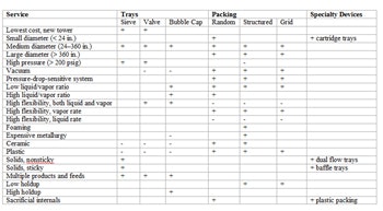

"Should we use packing or trays?" That's a critical early question when building a new distillation column. Specific services with special requirements may make a relatively unusual type of tray or packing the best choice. However, some general guidelines often apply. Table 1 summarizes these, with choices notably better for a given factor marked with a "+" and those particularly problem prone with a "-".

Table 1. Deciding upon the most appropriate internal may require balancing a number of issues.
