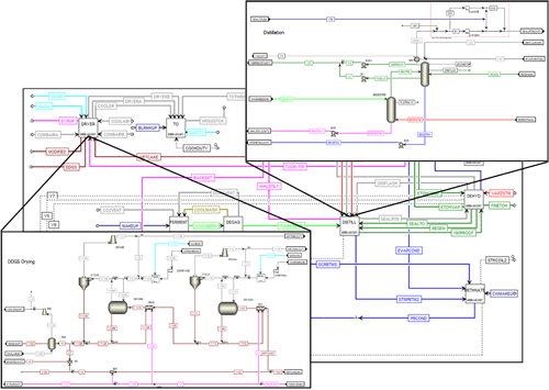

Fuel-Ethanol Plant
Figure 1. Model covers all parts of the process, with hierarchy blocks (such as the two insets shown) providing additional detail.

For a stair-step debottlenecking analysis, a model representation of the entire process is vital. This whole-process approach avoids implementing solutions that merely move problems to another area. Figure 1 shows a dry-mill fuel-ethanol plant model flowsheet to give an indication of the level of detail necessary to represent the process.
All parts of the process, from feedstock to salable products, appear in the model. Each “hierarchy block” contains additional process detail that includes all major and some minor equipment. The model also must be able to accurately determine utility consumptions.
