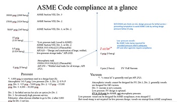

First, let’s define a low-pressure vessel according to the standards that apply in the United States. Such a vessel has a design pressure of 15 psig or lower. It may or may not be designed for full vacuum (FV). Most manufacturers will assume you want a new vessel designed for FV, i.e., 15-psig external pressure. You may think that you can save a few dollars by not requiring an FV rating but you probably won’t. By the way, the ASME code considers 15 psig, not atmospheric pressure, as FV.
ASME Code Compliance At A Glance
Here is a simple look-up chart for compliance with ASME Section VIII, Unfired Vessel regulations. Source: Dirk Willard
Here’s another point: ASME Section VIII, Division 1 and Division 2 don’t cover external pressure; they only pertain to internal pressure measured at the top of the vessel. It’s the responsibility of the fabricator to design the vessel bottom for static pressure, such as that of a height of liquid. As far as I understand, ASME doesn’t require a stamp if the bottom pressure exceeds 15 psig.
I must stress that there’s no reason, other than cost, not to design a vessel to ASME Section VIII standards. It’s even possible to get a U stamp for a low-pressure vessel. The cost is about $800 (as of 2018) for a stamp, excluding a pressure test, an inspection report, and calculations by a professional engineer; with those, the tab increases to ≈$7,000. A new vessel also will require a mill chemical test (which is done by the metal producer, not the fabricator). If this is missing, you must perform positive material identification (PMI) by x-ray fluorescence (XRF) or optical emission spectroscopy; XRF is easiest to use. A PMI usually looks at the heads, shell and, especially, weld seams. An inspection report also generally requires an ultrasonic thickness test spaced along the length of the shell, at nozzles and knuckles, and on the heads. This underscores the advantage of insisting upon a low-pressure vessel designed to meet ASME code — you’re assured of quality. Far too often a non-code low-pressure vessel is just slapped together with different materials and welds, inappropriate nozzle connections and even nozzles installed on knuckle seamlines. You don’t want that kind of surprise!
