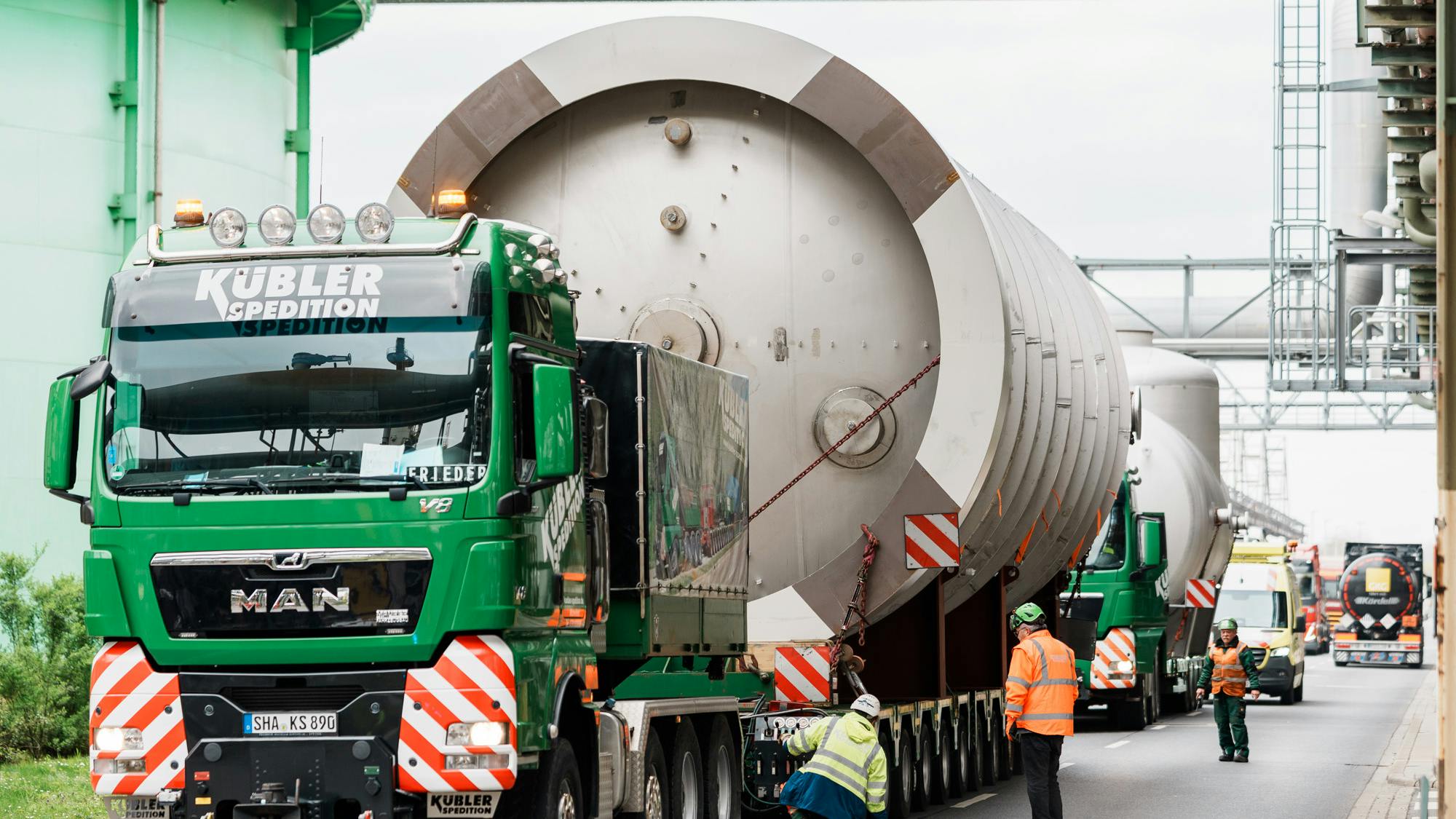

BASF announced that a major component for its industrial heat pump project at its Ludwigshafen site has arrived and is being installed. The company said the 95-ton plate falling-film evaporator was transported from Schwedt to Ludwigshafen by waterway before being moved to the construction site by heavy-haul truck.
According to BASF, the evaporator is a key component in the industrial heat pump because it generates oxygen-free steam for use in production plants across the site’s Verbund network. The steam will primarily support formic acid production.
