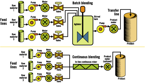

Finally, batch blending involves much more equipment than continuous blending. See Fig. 1.
Figure 1. Comparison of Conventional Batch and Continuous Blending
Continuous blending requires smaller equipment, less floor space and a smaller product storage area than batch blending.
Small additions cannot be accomplished accurately if a single large scale is used. If used, they can be expensive to maintain and keep in calibration. Agitators also affect weigh cells. Noise resulting from liquid turbulence must be filtered out. This equipment usage requires more maintenance than continuously operated smaller equipment.
Volumetric meters have a lower accuracy than coriolis meters, and some have longer ramp-up and decay periods, leading to inaccuracies. Additional power is consumed for pumps and agitators, and more pressure and level instruments are needed.

Continuous blending ," measuring and mixing raw materials within the pipe as the material flows to produce exact proportions and meet specific recipe requirements ," delivers the same accuracy as ," or better accuracy than ," batch blending.
