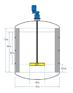

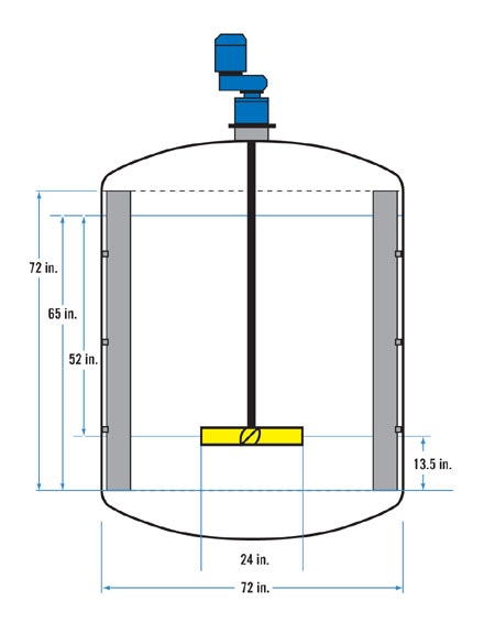

The simple and effective solution to mixer and tank compatibility problems is a scale sketch or drawing. Fig. 1 shows an example of a scale drawing generated by CerebroMix Light II, a computer program from CerebroMix Inc., Campinas, Brazil.
Figure 1. Ensure Perfect Fit
A properly scaled drawing ensures that correct mixer shaft length and impeller sizes are chosen.
Visual observation often provides a clue to potential problems. You should draw the tank to scale, including nozzle-mounting dimensions. You then can draw the mixer inside the tank, with the impeller locations properly scaled. Finally, the liquid level needs to be shown so you can check for effective operation.
An often-overlooked consideration in liquid-level determination is the space occupied by the mixer, baffles and other tank internals. For mixers with common pitched-blade, straight-blade and hydrofoil impellers, designers generally can assume the internals occupy about 10 percent of the open tank volume. In other words, expect and plan for the liquid level to be about 10 percent higher than that calculated from the inside tank dimensions.

Additional information about fluid properties and operating speed allows the calculation of mixing intensity. For example, the mixer in Fig. 1, operating at 100 revolutions per minute (rpm) in a fluid with a 1.1 specific gravity and a 150-centipoise (cp) viscosity, will create a mixing intensity of about 3.5 for liquid blending. This intensity, on a 1-to-10 scale, represents something in the low-to-moderate range. The impeller power is about 0.8 horsepower (hp), requiring at minimum a 1-hp motor.
For the same geometry and process conditions, an increase in the rotational speed to 250 rpm would increase the mixing intensity to 8.8 and require about 10 hp. A decrease in the speed to 37 rpm reduces the mixing intensity to 1.2, but requires less than 0.05 hp at the impeller. Computer software such as CerebroMix Light II provides a convenient means to calculate and test alternatives.
