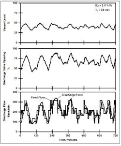

Figure 2 presents the performance for the following tuning: Kc = 2.0 %/% (a modest amplification of the measurement noise); and TI = 1.33 min (the same as suggested by the tuning equations).
The previous article demonstrated this tuning produces a cycle in a noise-free environment. Figure 2 depicts a similar cycle. The variability in feed flow makes the cycle more difficult to quantify. However, especially in the controller output, cycles of a sinusoidal nature are evident in most intervals of the response. The 12-hr period covered in Figure 2 shows at least 26 distinct peaks. This suggests a period (P) of 720/26 = 27.7 min. Arbitrarily selecting two of the peaks gives a period of 18 min. In either case, a reset time of 1.33 min is far too short  --  TI should be at least half the period of the cycle.
Sinusoidal Cycles
Figure 2. At least 26 peaks occur over 12-hr period.
Visually assessing the nature of cycles in a response is both imprecise and somewhat subjective. Although not routinely applied in the process industries, a more rigorous approach is to apply the Fourier integral to determine the contribution from each frequency to the response. Those loops that exhibit cycles deserve attention. A cycle usually has consequences, so you must understand its origin. Perhaps the cycle stems from the controller or perhaps it originates with a disturbance.
Figure 3 repeats Figure 2 with a TI of 24 min, which hopefully is close to the period of the cycles in Figure 2. Consistent cycles of a sinusoidal nature no longer are evident in the vessel level or controller output. However, this comes at a cost. As the controller is made less aggressive, deviations in vessel level from its set point (SP) increase, as shown in Table 1.
Reducing Kc has a larger adverse effect on performance than increasing TI.

Smaller Kc values than those computed above often prove acceptable. Figure 4 illustrates the performance of the controller for a Kc of 0.4 %/% and a TI of 24 min. Even with this low sensitivity for the controller, discharge flow varies considerably. On one occasion, the discharge flow changes from approximately 350 liters/min to approximately 100 liters/min in about 1 hr. During this same period, vessel level varies from just over 75% to under 10% (but above 5%, so there's no process trip).
The vessel level trend in Figure 4 exhibits a cycle with a period of approximately 200 min. The total duration of the trend is only 12 hr., though, which isn't long enough to be certain a cycle definitely exists. However, let's assume it does. A TI of 24 min is far shorter than half the period of the cycle. Reducing Kc to 2 %/% from 46 %/% mandates a significant increase in TI; so it seems logical that decreasing Kc to 0.4 %/% from 2 %/% also should require an increase in TI.
Figure 5 presents the performance for a Kc of 0.4 %/% and a TI of 120 min, which is twice the residence time of the vessel. A cycle still might exist but it's not as evident or as regular as the one in Figure 4. Even so, its period is roughly 3 hr, so a TI of 2 hr exceeds half the period of the cycle.
The performance in Figure 5 generally is preferable to that in Figure 4 (with a TI of 24 min). The variations both in vessel level and discharge valve opening (and consequently discharge flow) clearly are less than in Figure 4. This underscores the need to use long values of TI when Kc is very low.
