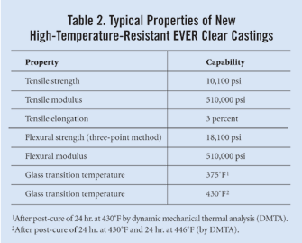

The recently commercialized resin discussed previously offers an increase in the glass transition temperature (Tg) to 375F (190C) and to 390F (200C) after post-cure. This temperature capability compares favorably to widely used novolac EVERs with a Tg of 330F (165C). The new resin's molecular backbone was altered to optimize heat resistance, adapting the co-monomer ratio to the needs of the application.
The resin has an epoxy novolac structure and chemical resistance characteristics comparable to resins currently in use. The key difference, however, centers on the acid resistance increase, which makes the new resin highly suitable for use in corrosive environments, including those conditions typically found in the gas inlet sections of scrubbers.
The resin's higher Tg makes it suitable for service in contact with gas temperatures as high as 410F (210C). It has a 3 percent tensile elongation and can easily withstand the cyclic stress induced by the thermal shocks typically found in scrubber quench applications. Table 2 summarizes these resin properties.
