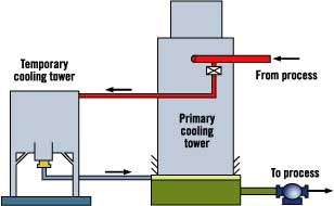

Augmentation
Temporary cooling towers also offer a quick fix to underperforming or overworked cooling towers. In some cases, the addition of temporary cooling capacity is a straight calculation of added operating costs for higher efficiency; justification of a capital cost does not enter into the equation.
Plants can augment current systems by diverting a portion of the hot water from the return line before it reaches the primary cooling tower. The diverted water then is sent to a temporary cooling tower, where it is cooled and then fed back into the primary cooling tower basin.
Augmentation is most effective when the primary and temporary cooling towers are working together. In other words, the plant first must establish the performance of the existing tower before it can accurately determine the amount of augmentation required.
For example, if a cooling tower is to cool 20,000 gpm from 110F to 90F at a 78F wet bulb, the plant would determine the impact of augmentation by reducing the water flow to the primary tower and maintaining the same temperature range. The cooling tower manufacturer should be able to provide information detailing the expected tower performance at varying water flow rates. The information will be in the form of curves or a printed table such as that shown below.
If the plant determines the optimum temperature reduction would be 3F, it would need to size the temporary cooling tower to cool 20 percent or 4,000 gpm from 107F to 87F at a 78F wet bulb. The primary tower and the temporary tower should be engineered to work as one. Any variation of this approach would require one of the towers to achieve a very close approach to the wet bulb temperature and will likely require more equipment and produce less desirable results.
With any augmentation, plants should consider:
How the reduced water flow will impact the water distribution of the primary tower. If too much water is diverted from the primary tower, the water distribution will be affected and might reduce part of the benefit provided by the temporary cooling towers. Rarely is it possible to augment more than 25 percent of the design water flow.
Prevailing winds. The temporary tower likely will be lower in profile and could potentially send its hot discharge air into the air inlet of the primary tower. It should be positioned cross- or downwind when possible.
Tower elevation. In some cases, the temporary cooling tower inlet might be higher than that of the primary tower and might require the plant to pinch back the valves to each cell of the primary tower to ensure adequate water to the temporary cooling tower. It is unlikely that the elevation difference will impact pump performance significantly; however, the difference should be considered.
Basin elevation. Some temporary towers can be elevated to allow the cooled water to be gravity fed from the temporary tower basin into the permanent cooling tower basin. If the primary tower basin is too high and pumps are required to pump the water from the temporary tower basin to the primary tower basin, the plant should consider special automated valves and a level controller.
Fig. 2 shows a typical cooling tower augmentation.
Figure 2. Typical Augmentation
