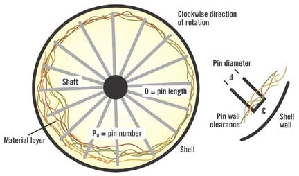

Pin mixer operation
A pin mixer, also called a turbulator in agglomeration circuits, consists of a number of pins placed on a rotating shaft inside a solid cylinder or shell. See Fig. 1.
Figure 1. Pin Mixer
The figure shows the basic design of a typical pin mixer.
The pins extend almost to the wall of the shell, but a clearance remains between the pins and the wall. The shaft rotates at high speeds, e.g., typically between 500 revolutions per minute (rpm) to 1,000 rpm. The hold-up (the amount of material held in the vessel) in pin mixers is very small, and the material's residence time is very short, on the order of three seconds to five seconds. The pin mixer quickly agglomerates powder into small spheres.
In many applications, a liquid sprayed within the vessel acts as a binder. Typically the liquid is water and might contain an additive to bring about the desired effect. The liquid spray typically is applied directly to the agitated bed. When it comes into contact with the particles, the liquid coalesces them into a single mass.
Pin mixer design
The pin mixer's pins can be configured in numerous arrangements, including straight, random or spiral. The spiral arrangement is preferred because it aids the passage of material through the mixer. The random pin arrangement has not been shown to be as effective and, therefore, is not used extensively.

Figure 2. Pin Passing through Material
The pin's tip speed, clearance and diameter are important mixer design considerations.
