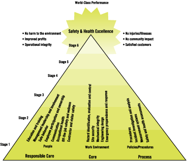

Designed to safeguard and promote the health and safety of chemical facility employees and visitors, the Employee Health and Safety Code calls on companies to make continuous improvements to workplace health and safety. Wickliffe, Ohio-based Lubrizol Corp. has been perfecting a process to do just that.
Termed the Lubrizol Safety and Health Excellence Process, it echoes the company's resolve to include additional management practices not incorporated into the original code. See Fig. 1. The multistage process provides a mechanism for world-class performance in the safety and health arena, encouraging proactive management upstream by emphasizing the safety system or process instead of the injury after the occurrence.
Figure 1. Excellence Process
"It's pretty easy for everybody to say they're committed," says Pete Lubs, Lubrizol's corporate code steward for the Employee Health and Safety Code, "but we want to work toward management's leading in the areas of employee health and safety, as well as becoming more involved in the health and safety process."
Some of the management practices in the Excellence Process are completely new, says Lubs, while others are combinations or modifications of what existed previously.
"Only we're raising the bar to make it more comprehensive and more of a best practice in the chemical industry compared to what had existed before," he stresses. "We're calling the first set of management practices the [Responsible Care] core process, and we're calling our new set of management practices the Excellence Process."
Before designing the Excellence Process, Lubrizol benchmarked itself against 11 other companies, taking a look at what the other companies were doing internally in relationship to their safety and health management practices. Its Texas facility was the first to commit to the new process; each of Lubrizol's other four major U.S. plants now is in the implementation process. According to Lubs, the process will be formally presented to the company's international facilities this month.
Implementation of the new process will take some time, notes Lubs, and the company has set no deadline for each site. "The only specific timeframe we have is to reduce our injuries and illnesses by the end of 2004 by 50 percent for our U.S. plants," he adds.
