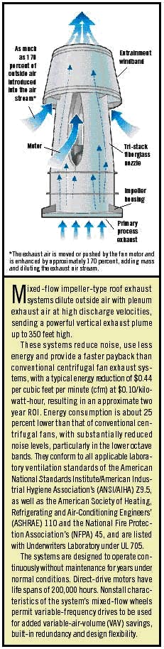

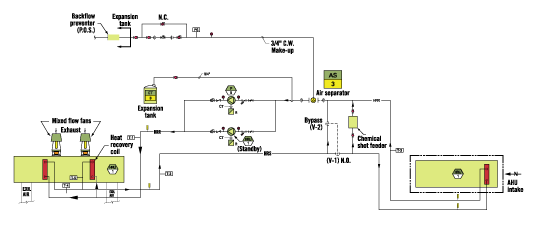

Fig. 1 shows a typical roof-mounted heat exchanger/mixed-flow impeller system. Fig. 2 provides a flow diagram of a heat exchanger system with two mixed-flow impeller exhaust systems.
Figure 1. Heat Exchanger/Mixed-flow Exhaust System
Figure 2. Runaround-Coil Heat Recovery Flow Diagram
