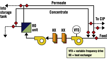

Fig. 3, Fig. 4 and Fig. 5 provide schematics for three basic system designs. In each design, a method to closely regulate feed pressure to the membranes during hot-water sanitation is employed by either a pressure-regulating valve or a variable-frequency drive for direct pump control. Fig. 4 and Fig. 5 provide designs with independent heating and cooling heat exchangers. Fig. 5 uses a common and dual-rated heat exchanger for both heating and cooling processes. In each case, the "hot" heat exchanger also serves to preheat RO feed water during normal operation.
It is assumed Fig. 3 and Fig. 4 use either sulfite chemical injection or ultraviolet (UV) technology for dechlorination. When using activated carbon (AC), as shown in Fig. 5, both the RO and AC could be hot-water sanitized during the same process.
Figure 3. Two-Heat-Exchanger System
with CIP/sanitation Tank, On-line/Off-line HXs
Figure 4. Two-Heat-Exchanger System with No Tank
Figure 5. One-Heat-Exchanger System
with Soft-water Tank, Feed-Water Cooling
