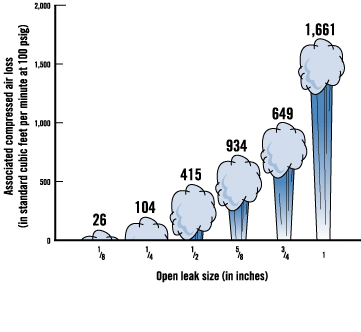

This study should include an aggressive leak detection/elimination program and investigate existing demand-side system components that could be improved. Even small leaks or inefficiencies in the system can waste a substantial amount of energy. See Fig. 2.
Figure 2. Energy-Savings Opportunities
