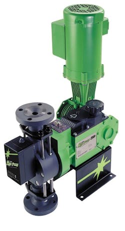

Pulsafeeder has introduced both hydraulically and mechanically actuated diaphragm pumps for metering applications; the units are called, respectively, the Pulsar HypoPump and Pulsar Shadow. The HypoPump is designed to handle relatively volatile hypochlorite solutions for wastewater treatment, while the Shadow boasts a rugged construction to minimize maintenance.

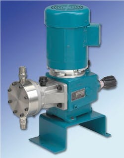

Meanwhile, Neptune has launched a mechanically actuated diaphragm pump for high-volume, viscous flows (300 gal/hr, viscosity above 5,000 cP) to extend the application range of its product line. "Mechanically actuated diaphragm pumps run cooler than hydraulic ones," Dowse says. "This pump also has the advantage of being self-priming."
Series 7000 mechanically actuated diaphragm metering pump can handle viscosities exceeding 5,000 cP.
Source: Neptune Chemical Pump

The Pulsar HypoPump for handling sodium hypochlorite features a patented design that allows pressurized process fluid to flush liquid cyclically through the pump's discharge check system.
Source: Pulsafeeder

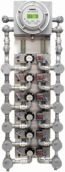

Mini-Pak manifold provides metering accuracy to 0.1% even at flowrates of over 600 gal./min.
Source: Lubrizol Performance Systems
Multiple feeds from a pump usually are routed through some type of manifold, and that manifold provides another point where flow control is possible. This is the design philosophy behind a product line from the Performance Systems Div. of Lubrizol Corp., Atlanta. The business grew out of Lubrizol's need to develop systems to inject additives into gasoline at fuel terminals -- where it retains a leading market share -- and now encompasses food processing, downstream oil production, defoaming and other applications.
Its Mini-Pak injector is a machined block of metal with ports for feedstreams, and connections to a solenoid valve, a gear-based flowmeter, and communications modules. The typical application, says Bill Silzle, division president, is for controlling the addition of a small quantity of an expensive component -- such as the dyes used in retail gasoline -- to a large flowstream, such as the fuel being dispensed into a delivery truck at a fuel terminal. The injector's flowmeter divides the flow into thousands of pulses, which are counted electronically and totalized for the desired flow input. Silzle says that the unit achieves metering accuracy to within 0.1%, even with flowrates in excess of 600 gal/min.
