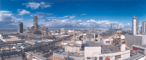

Figure 1. DSM’s largest site, at Geleen, The Netherlands, has achieved significant savings by using software to optimize energy costs in real time. The Texas pool partnership was announced earlier this year and Ruthven says PPM has been gathering information on companies’ power loads since then, with the aim of proposing detailed pooling plans to the firms in the fall. “The potential is large,” he says. “We have received letters of intent so far for 120,000 MWh of conditional loads to pool, and we haven’t yet covered the whole range of possible participants.” This compares with PPM’s first pool of some 140,000 MWh, set up for another industry sector around the time of deregulation.

Petela maintains that “model-based software solutions are now enabling companies to both manage and optimize their energy systems, taking into account the specific operating constraints and cost drivers at individual sites.” The results can be seen at DSM’s largest chemicals complex at Geleen in the Netherlands. This huge site has implemented Aspentech’s “aspenONE energy management for chemicals” software to optimize its energy costs in real time.
“Since we are dealing with complex contracts that specify the amount of energy we can consume, we needed a solution that would allow us to forecast and optimize our energy consumption for the year to improve our utility rates and help us avoid millions of euros in fines,” explains Geert-Jan de Laat, DSM’s modeling competence manager. He quantifies the benefits to DSM as up to 3% reduction in energy consumption, 4% in operating costs, and — significantly in such a tightly regulated market — an insight into negotiating better rates with energy suppliers.
