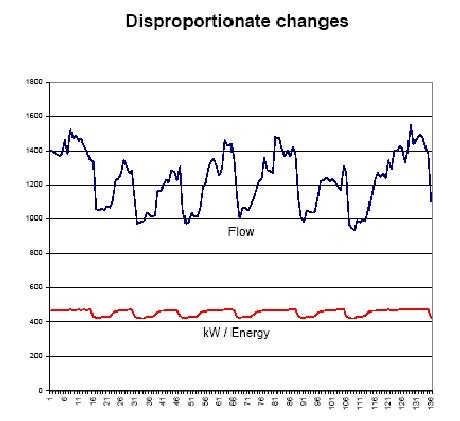

A well-managed system
How do you know when your air compressor system is performing at maximum efficiency?
Figure 8. In a poorly managed system, power usage does not respond to change in demand.
Figure 8 shows a stable well-managed system. A conservation program is in-place, air quality meets standards, and pressure drops have been eliminated on both the demand-side and supply-side. The trouble is that the cost savings are impressive but the power usage is still a little higher than expected — what’s wrong? Look at Figure 8. The chart shows that power doesn’t respond to demand, i.e., flow: reduced demand should mean less power — right? What is needed is an air management system to assure that all compressors run at full-load efficiency. This system must have software capable of analyzing operating condition, compressor load condition, and adjusting to pressure change — either rise or decay. The net result will be all units on at full demand (load), one on at partial load, and all other off, 80% to 85% of the time. Figure 9 shows the results of installing a management system.
