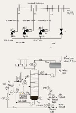

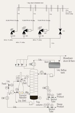

April's Puzzler
During a routine walkthrough at a new job we found a problem with how the relief valves are laid out for a distillation column (Figure 2). After further thought, we wondered if the piping is undersized. A review of the relief scenario and a mechanical sketch of the piping reveal some background. The relief valves are sized for a total flow of 170,000 lb/hr for fire and other scenarios; fire isn’t the worst. All valves are conventional, not pilot valves or balanced bellows. Sizing was performed for a mixture in the column of 64% ethanol and 36% ethyl acetate. The relief conditions were: 150 psig and 149ºC. There are other problems with the set-up, which need to go to the maintenance manager right away. What should go in the report? What must be done to improve the safety of the relief system?
Figure 2. What is wrong with this pressure relief system? (Click to enlarge.)
Send us your comments, suggestions or solutions for this question by March 16, 2007. We’ll include as many of them as possible in the April 2007 issue and all on CP.com. Send visuals — a sketch is fine. E-mail us at [email protected] or mail to ProcessPuzzler, Chemical Processing, 555 W. Pierce Rd., Suite 301, Itasca, IL 60143. Fax: (630) 467-1120. Please include your name, title, location and company affiliation in the response.
