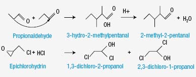

Historically most organic waste producers find that storing RCls in a wet environment can be corrosive to carbon steel equipment because these streams often contain trace levels of HCl. Hence, Dow, which had constructed its the RCl mix storage and pipeline systems of carbon steel, set a specification that all RCl feeds contain <50 ppm water. Introduction of Stream 3 to the mixed RCl system in 2004 resulted in the detection of 300 ppm to 700 ppm water in the blended material. Therefore, Stream 3 was removed and a series of root-cause investigations proceeded.
As with many problems involving chemistry, the high concentration of water in the RCl mix wasn’t fully understood. Max Lee, senior research chemist, recalls, “the production people were questioning the analytical method accuracy because dry streams were blended resulting in a wet tank stream.” A series of research studies were conducted to understand the water formation mechanism and to develop a method of mixing Stream 3 with other feeds to the HCl unit. The ultimate goal was to reduce the corrosiveness of the feeds. Research revealed that trace HCl in the other RCls was catalyzing a reaction with certain oxygenated components in Stream 3 to create the water. Further work identified the mechanism for these reactions: aldol condensation of propionaldehyde, which was found as a waste in the Stream 3 (Figure 2).
Figure 2. Discovering the source of the excess water in the product was the first step in eliminating the corrosion problem.

Jeff Birdwell, process chemist, said “water isn’t the problem, corrosion is. Why not use the excess epichlorohydrin in the stream to consume the HCl?” Subsequent laboratory mixing and corrosion studies revealed that epichlorohydrin, also contained in Stream 3, did consume the HCl and yielded a noncorrosive mixture.
