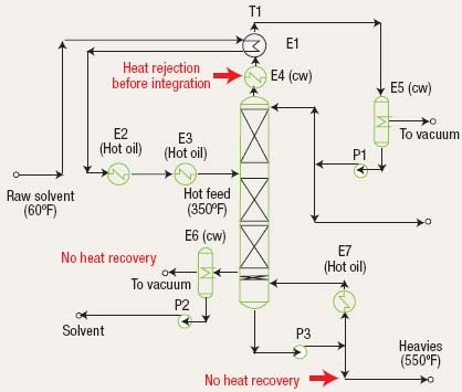

Have you checked basic heat integration?
Never presume that a plant’s current heat-integration configuration is logical, let alone optimal. Consider the quirky scheme used in a solvent recovery plant (Figure 6).
Figure 6. The scheme boasts an unusual element and the opportunity for significant improvement.
The overhead is heat integrated after the first cooling-water exchanger, which is really unusual and has never been adequately explained. Also, while the overhead is heat integrated, neither the hot vapor sidedraw nor the tower bottoms streams have heat recovery.
The fix (Figure 7) was to reconfigure the overhead system and add heat recovery.
Figure 7. Investment in reconfiguration and added heat recovery was paid back in a few months.
The sequence of overhead exchangers was reversed to heat-integrate before going to cooling water. One existing hot-oil exchanger was converted to feed preheat versus the vapor product draw. Finally, a new heat-recovery exchanger was added to the bottoms stream (10% of feed flow). One hot-oil exchanger was left on the feed stream (E3) to make the unit easier to start-up. Although the unit has a feed rate of only 360 gal/hr the heat duty was reduced by 3 million btu/hr. The changes involved a capital expenditure of less than $100,000 and yielded a savings of $280,000 per year.
Many other plants can take advantage of simple heat-integration steps between tower feed and tower bottoms. Don’t overlook these relatively easy ways to save money.
