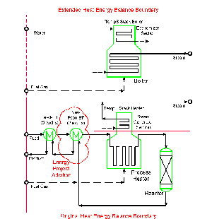

Consider the situation faced by a plant with a high-temperature reactor system. A fired process heater provided duty to get up to the required reaction temperature. A conventional feed/effluent exchanger system recovered duty upstream of the heater, reducing the heater duty. The feed/effluent heat recovery used five TEMA E-type shells in series.
The heater also included a steam generator system that provided medium-pressure steam for a variety of plant uses. Process demands set the heater duty requirement, causing steam generation to vary. The stack temperature out of the steam generator (convection) section stayed close to 520°F.
Temperature-cross pinches (www.ChemicalProcessing.com/articles/2007/070.html) in the feed/effluent exchangers limited heat recovery. One energy conservation project considered adding two feed/effluent exchangers to make a total of seven shells in series. At first glance, the energy recovery seemed to offer reasonable return on investment. Figure 1 shows a simplified plant sketch along with the heat balance boundary used for project analysis (solid boundary line). The new feed/effluent exchangers reduced process heater firing.
Has this analysis found the "right" answer? Further investigation raises serious doubts. Reduced firing on the process heater decreases the stack-gas flow rate to the convection section. The nearly constant stack temperature on the process heater results from a large convection section. The stack temperature pinches against steam production temperature. Therefore, the reduced heater firing, as set by the process requirement, also gives a nearly linear drop in steam production.
The Bigger Picture
Figure 1. Taking into account its impact on the boiler gave the project a marginal return.
However, plant steam demand stays the same. So, some other part of the plant must provide the steam. In this case, the boiler firing goes up and boiler fuel demand rises. The added feed/effluent exchangers shift more duty to the boilers. The extended heat balance boundary (shown by the dashed line on Figure 1) gives the correct energy balance -- including the effect of the changes on the steam system.
What is the net energy savings of the project? A quick analysis compares stack temperatures. The boiler stack temperature runs around 350°F while the process heater stack temperature runs around 520°F. Yes, the project saves energy -- but not very much. Detailed analysis also would include efficiency differences between different fuel types, air preheat changes and many other factors. But by itself just comparing stack temperatures gives a rough 4%–4.5% energy savings on the extra duty provided by the two new exchangers. Few projects will make the cut with this low a benefit.
