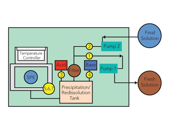

Metal Removal Technology
Figure 1. Shown is a schematic of the Cyclic Electrowinning/Precipitation (CEP) system used to remove particles containing metals from aqueous solutions. Source: Brown University.
"For an initial 10-ppm ion concentration of the metals considered, the volume reduction is on the order of 106," say the researchers. Moreover, the system does away with the need for sludge disposal.
