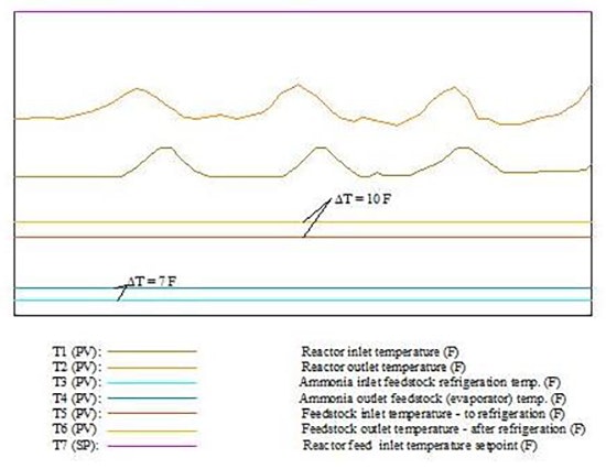

Cooling problems plague our chemical plant, especially on days when the temperature rises above 95°F and the humidity exceeds 85% (see Figure 1).
Corporate engineering completed a plant expansion a couple of winters ago; since then, cooling has become a recurring problem every summer starting in June and going on until late September.
In response, at the suggestion of corporate, we put in larger batch reactors and distillation towers and added a cooling tower to supplement the old 1970s one that has served us so well.
Critical Process Temperatures
Figure 1. The temperature differential of the feedstock and of ammonia in the refrigeration system both have dropped.
It’s probably worth mentioning that we changed our feedstock source. We had been making it ourselves but several near-misses at the feedstock unit prompted corporate to close it down. Now, we import feedstock from offshore; we’re still waiting to establish quality control procedures on the new feedstock.
I’m concerned about the low temperature differential across the ammonia refrigeration system: the vaporizer (NH3feedstock) and condenser (NH3/tower water) don’t have the same differential temperature as before. Before the expansion, we saw a 17°F change in feedstock temperature, now it’s only 10°F. The ammonia differential had been 12°F but currently is 7°F. Also, I noticed that the ammonia compressor is running hotter and the inlet temperature to the ammonia condenser also is a little hotter. What does all this mean? What can we do?
