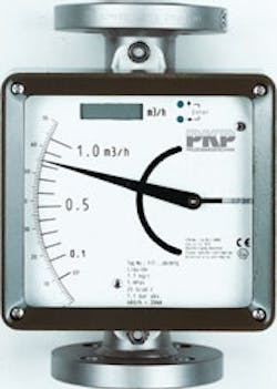

Model DS25 is constructed of 316 stainless steel and is suitable for measuring and monitoring the flow of aggressive media and for use in food and drink applications, according to the company. The flow meters can be provided with Tri-Clamp or other hygienic connections.
The DS25 works on the variable area principal and utilizes a float that is guided in a cylindrical measuring tube by means of a slotted nozzle. The flowing medium moves the float in the flow direction. An externally mounted pointer indicator magnetically coupled to the float indicates flow rate against a calibrated or arbitrary scale.  The indicator assembly also houses optional alarm outputs, analog output and totalizer. Other options include explosion proof model, oxygen cleaning, steam jacketing for temperature control and temperature isolation of electronics for high temperature applications.
