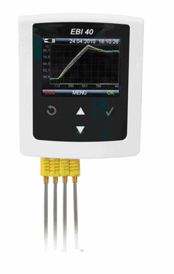

ITT Corp. has launched the first of ebro EBI 40 multi-channel data loggers from ITT Analytics. The 12-channel thermocouple data logger is suitable for thermal mapping in food, industrial, pharmaceutical and general lab applications.
The data logger has been designed for a wide range of applications, including the measurement of core temperatures during baking processes, monitoring baking and freezing procedures and validation of dry heat sterilizers. In addition, the system enables qualification of coating lines and heat distribution studies in thermal chambers. The instrument provides users with increased productivity and performance, which can result in significant cost savings and increased product output.
The data logger offers a temperature measurement range of -200 degrees Celsius to 1,200 degrees Celsius. Measurement intervals are also operator programmable from 0.1 second to 24 hours. The system is capable of storing up to 240,000 values per channel, while its large color display allows users to inspect measurement values continuously. In addition to standard programming and data retrieval by the software, the USB connection enables these functions to be facilitated via USB stick offering greater flexibility for field applications.
