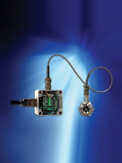

Flow Technology, Inc., a leading manufacturer of precision flow measurement instruments, systems and calibrators, today announced the FT-BD turbine flow meter system. An accurate solution for measuring bi-directional flow in a wide range of liquid applications, this advanced system can also compensate for viscosity changes due to variations in ambient fluid operating temperature, which affect the accuracy of flow measurement data.
In various industrial and test & measurement processes, bi-directional flow presents difficult challenges for flow metering equipment. For example, utility pumping and circulating plants pump dielectric fluid into underground electrical cables in order to dissipate heat generated by high-voltage power lines. This application involves monitoring upstream and downstream flow rates. It also requires a precise method of viscosity compensation as the dielectric temperature changes.
Employing Flow Technology's FT Series turbine flowmeter paired with the LinearLink Temperature Compensated Interface (TCI), the FT-BD system provides bi-directional flow measurements in a host of hydraulic, pneumatic and pumping applications. The FT Series meter is an ideal choice when high accuracy, compact size and fast response are critical. The LinearLink TCI is a sophisticated electronics platform for flow meter linearization, viscosity correction and density compensation.
