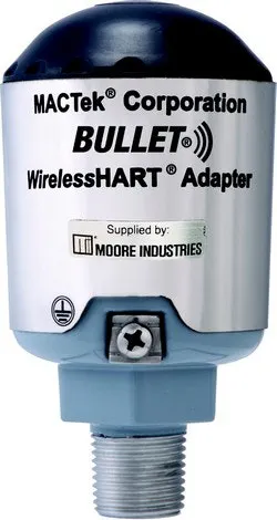

Bullet can connect directly to a HART device or at any junction box along the HART 4–20mA loop.
Nov. 30, 2012
The Bullet WirelessHART adapter sends process signals from up to eight multi-dropped smart HART transmitters on a WirelessHART link. Supporting both WirelessHART mesh and star network configurations, the Bullet can connect directly to a HART device or at any junction box along the HART 4–20mA loop.
It sends process signals including first, second, third and fourth measurement variables, custom diagnostic and alarm data and custom commands. It also accepts analog signals such as 4–20mA, making it an ideal choice for adapting legacy analog instruments to WirelessHART networks, the company claims.
