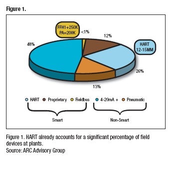

According to the ARC Advisory Group, Dedham, Mass., 40-45 million field devices are now installed worldwide — approximately one-half are analog and another one-fourth are HART (Figure 1). So, there is a pre-existing knowledge base among operations and maintenance personnel when upgrading 4-20-mA devices to HART. And these are the people who would use the hardware and software tools, such as handheld communicators and plant asset management software, for communicating with HART devices.
