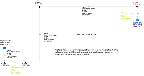

We use N2 at 31 psig to drive 2,200 gallons of a viscous polymer at 235°F through an electrically heat traced and insulated 2-in., sch-10, 347-ft line from a reactor, which, once emptied, is ready for the next batch (Figure 1). This takes about 210 minutes. Initially, we can put about 25 gpm through the pipe. By the time we’re done, the polymer viscosity has doubled from 380 cP and the flow has dropped to 13.8 gpm. The polymer specific gravity is about 1.05 at 235°F. The reactor is rated for 40 psig. Originally, we used lobe pumps; we switched to the pressurized system because of monomer emissions, contamination of pump barrier fluid, a heel in the reactor, and shearing by the pump. Even with N2, the product continues to cross-link, resulting in the increased viscosity and the slowed-down transfer. Measurements show that the apparent viscosity increases to 1,200 cP for a 3-in. line and 3,600 cP for a 4-in. line. How can we speed up the process? The production manager wants the transfer only to take 30 minutes but believes that boosting the polymer flow rate will substantially increase the N2 demand. What do you think?
