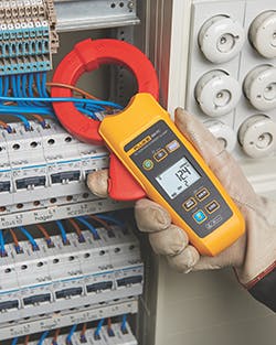

New Fluke 368 FC and 369 FC Leakage Current Clamps help industrial electricians and maintenance technicians identify, document, record and compare leakage current readings over time to help prevent problems before they happen without shutting down critical equipment.
The rugged meters have large diameter jaws (40 mm for the 368 FC; 61 mm for the 369 FC) for work with oversize conductors. The clamp jaws are fully shielded and designed to accurately capture very small leakage current signals (as low as 10 μA) and minimize external electromagnetic interference. The true-rms meters accurately measure complex signals, with the highest resolution of 1 µA and an upper measurement range of 60 amps.
The CAT III 600 V safety rated clamp meters feature a forward-facing LED worklight for use in dark wiring cabinets, a backlit display with auto-off and auto-power-off for extended battery life.
The 368 FC and 369 FC are part of Fluke Connect, a system of more than 40 wireless test tools that communicate via the Fluke Connect app, or Fluke Connect Assets software.
