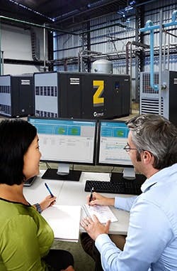

Figure 1. Continuous tracking can make both auditing and optimization faster. Source: Atlas Copco.

The remote technology also monitors energy usage, helping plants track, trace and optimize what they are doing (Figure 1). In the past, tracking such air demands only was possible by installing a data-logging unit on the compressor, letting it run for a week, taking it off, downloading and analyzing the data, and presenting the findings.
“This process, which could take several weeks, can now be completed in a few hours and, more importantly, can be constantly monitored — not just for short periods. Because these systems use cellular technology, there is no need to connect directly into the customer’s network. However, if a customer wants the data connected directly to their network to allay security concerns, that is easy to do,” he adds.

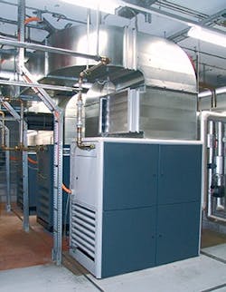

Figure 2. Reliable and relevant process data can spur substantial savings in compressed air systems. Source: Endress+Hauser Flowtec.

In managing a compressed air system (Figure 2), certain parameters are extremely important for smooth and efficient delivery of compressed air, he points out. Ensuring the correct pressure, for example, typically requires measurements at multiple points within a compressed air network and usually always at the points of use. This way, a plant can confirm the pressure suffices for successful operation or take corrective measures if necessary. Monitoring of the compressed air’s quality, particularly its dewpoint, also is crucial to protect sensitive equipment or processes that the presence of water could harm.
