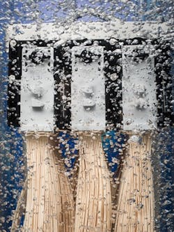

Ultrafiltration
Figure 2. Following treatment in a membrane bioreactor, water goes to hollow-fiber membranes.

Stages 3 and 4 — Membrane bioreactor (MBR) and centrifuge. Following separation, the wastewater goes to an MBR. First, biological treatment breaks down VOCs and ammonia in the water. Then, the water is filtered using SUEZ’s ZeeWeed 500 ultrafiltration hollow-fiber membranes (Figure 2). This combined treatment creates a permeate. Stage 3 utilizes SUEZ’s BioPlus BA2970 and BioPlus BA3900 chemistry for biological seeding and bioaugmentation in the biological reactor, and FoamTrol AF3031 for foam control there.
