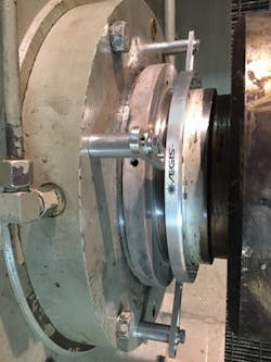

Figure 1. Installing device on shaft of 400-hp fan motor for thermal oxidizer eliminated problems from stray currents.

When Fisher arrived at the plant in May 2017, he took shaft voltage readings on the 30-hp and 150-hp centrifuge motors and the 400-hp fan motor for the plant’s thermal oxidizer. These motors exhibited premature bearing damage — long before reaching the L10 life of their bearings, i.e., the life that 90% of the bearings should achieve. He knew right away the culprits were stray currents from VFD-induced voltages that were building up on motor shafts and discharging through motor bearings — and just how to deal with them.
VFD-induced shaft currents discharge to ground along the path of least resistance. Without long-term shaft grounding, that path typically is through the motor bearings. So, Fisher recommended installing Aegis shaft grounding rings on all motors controlled by VFDs to channel these harmful discharges away from bearings and safely to ground.
He chose split Aegis SGR Rings for the 30-hp and 150-hp centrifuge motors. These rings come in mating halves that allow fast, easy installation on an in-service motor without having to decouple the motor from attached equipment. After removing any dirt, corrosion and paint that might interfere with adhesion and conductivity, Fisher installed the rings using conductive epoxy.
Because of the 400-hp motor’s large size, Fisher opted for an Aegis Pro Series Ring. Designed for large low- and medium-voltage motors, Pro Series Rings have six rows of conductive microfiber brushes that provide high current capacity. Fisher installed the larger split Pro Ring using universal Pro Series mounting brackets.
Once the installations were completed in July 2017, he took follow-up readings on the running motors to check shaft voltage levels. Readings that were as high as 19 volts before had dropped to less than 1.3 volts (too low to cause premature bearing damage) after the installation of the rings.
