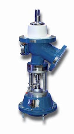

The manufacturing processes can be monitored with sensors that are installed either directly in the vessel or in the pipeline. If effective process analysis requires sensor installation in the vessel, a suitable entry point must be found. However, modification of existing vessels is prohibitively expensive, involves revalidation and, sometimes, is not even permitted. Entry from the top also can be a problem for low volume batches. So, when a large global pharmaceutical manufacturer wanted to add a sensor to some reactors at a plant in Ireland, it opted for an innovative, cost-effective solution — a bottom outlet valve that incorporates a sensor that quickly and accurately monitors concentrations, phase separations and chemical changes in process liquids (Figure 1). This eliminated the need to modify the existing vessels.
Valve With Integrated Sensor
Figure 1. Bottom outlet valve incorporates a sensor for measuring concentrations, phase changes and chemical changes in process liquids.
The PAT sensor is an integral part of the valve disc and is directly exposed to the liquid in the vessel. The combination allows an effective inline measurement of relevant parameters without any process connection adapter. It provides a low-cost option for implementing modern PAT in both existing and new vessels.
Because the sensor is located in the bottom part of the vessel, even low-volume batches can be monitored in real time. If necessary, the sensor can be removed quickly between batches without having to extract the valve from the vessel. The valve, made by SchuF of Germany, comes in a wide variety of specifications, including various actuator types, sizes, accessories and materials such as stainless steel, high-nickel alloy, glass or perfluoro-alkoxy polymer lining.
