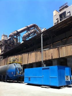

LABORATORY AT CEMENT PLANT
Figure 2. Vertical pipes provide laboratory (blue container) with flue gas directly from stack. Source: Oakbio.
ALBERTA-BACKED INITIATIVESMeanwhile Oakbio, Sunnyvale, Calif., and Liquid Light, Monmouth Junction, N.J., are among 24 groups that each will receive C$500,000 ($454,000) from the Climate Change and Emissions Management Corp. (CCEMC), Sherwood Park, Alberta, as part of its C$35-million (U.S.$31.8-million) international competition for technology to markedly cut greenhouse gas (GHG) emissions by creating new carbon-based products and markets. (For more details, see: “Carbon Competition Names First Round Winners").Oakbio has created a technology that uses chemoautotrophic microbes to produce a number of chemicals from industrial waste, carbon dioxide and energy. Currently the company’s main products are polyhydroxyalkanoate (PHA) polymers and n-butanol. “Because we run a co-located flue-gas test laboratory at Lehigh Southwest Cement (Figure 2), Tehachapi, Calif., we were able to develop flue-gas-resistant strains using actual unadulterated flue gas and achieve up to 70% dry-weight yield of PHAs,” says Brian Sefton, Oakbio’s president and chief scientist.The Lehigh project is significant because cement production currently accounts for 5–8% of global carbon dioxide release, according to Sefton. Lehigh itself produces 1 million t/y of the greenhouse gas.Capture and conversion of carbon dioxide from the plant would yield over $1 billion/yr of PHA or other products, Sefton notes. It also would increase the value of the cement produced there because builders could claim credits for achieving green building standards by using it, he adds. On a broader note, capturing and converting the 2 billion t/y of carbon dioxide emitted by the worldwide cement industry could supply the entire global plastics market, he says.Oakbio’s n-butanol is the newer of the two products. “This is an important chemical feedstock as well as a drop-in biofuel with an octane rating similar to gasoline. This model is also capable of producing thousands of other compounds, many of which we have made in small amounts already such as diacids, ketones, esters, fatty acids and organic acids,” notes Sefton.The company currently uses bioreactors that vary in volume from 250 ml to 20 L. Oakbio is raising funds to take this program to pilot scale of 1,000–5,000 L.The process has a number of advantages, says Sefton. First, it requires no costly extra ingredients such as promotors or antibiotics. This means the process water is very clean and can be re-used easily. “In addition, the process can uptake organic acids, acetone, benzene, diesel fuel and many other chemical compounds which are considered waste, including even dioxin, and break these down into energy and feedstocks for our target compounds.”Oakbio is working closely with Ohio State University, Columbus, Ohio, to leverage the school’s molecular biology and enzymology expertise to increase n-butanol production to commercial levels. Sefton expects to achieve this in two years. The PHA process is cost competitive and projected to be profitable at scale, he notes, while the n-butanol business is projected to be profitable once production levels reach the company target. Several chemical companies and fuel producers are watching developments closely, Sefton adds.
