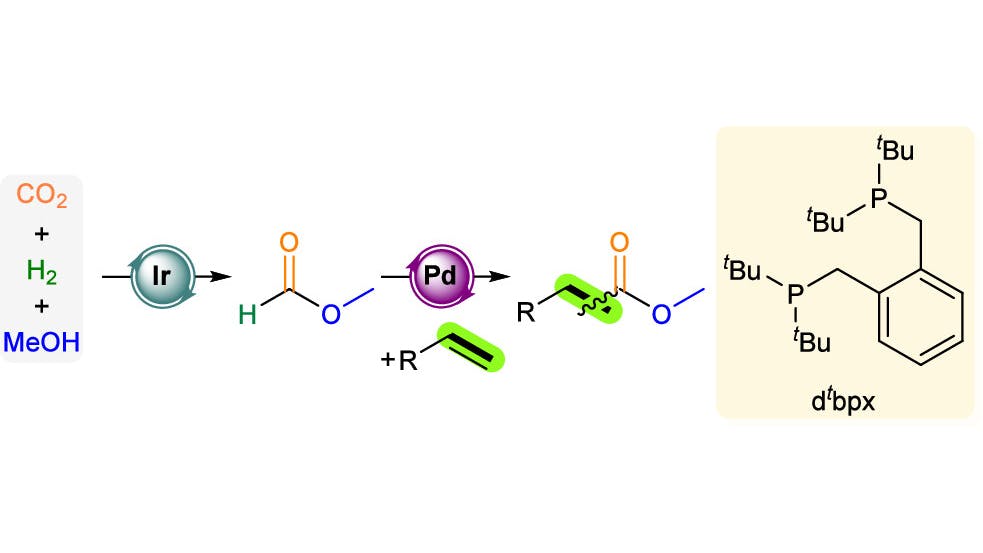

Researchers from an Evonik subsidiary and university partners in Germany have developed a catalyst system that enables carbon dioxide to serve as a raw material for producing industrial chemicals such as fragrances and plastic precursors. The study, published Aug. 28 in the Journal of the American Chemical Society, demonstrates a potential route toward more sustainable chemical manufacturing.
The research team included scientists from  Leibniz Institute for Catalysis (LIKAT), Ruhr University Bochum, and Evonik Oxeno. The team’s bimetallic catalyst combines iridium and palladium with an industrial phosphine ligand to drive carbonylation reactions that traditionally rely on carbon monoxide.
In this process, olefins are converted into esters using carbon dioxide and green hydrogen, eliminating the need for toxic feedstocks. The system also showed high selectivity for linear products, which are valued in both bulk and specialty chemical production.
