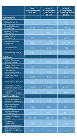

MIXING SIMULATIONS
A number of software programs can handle the analysis and scaleup of mixing systems for crystallization and precipitations. One I've successfully employed is Visimix.
Such a program enables investigating different scenarios for scaleup as well as changes in agitator and vessel configuration. Table 1 presents the Visimix output for a geometric scaleup of a reaction crystallization from 50 gal to 6,250 gal, the first with constant power input to volume (P/V) and the second with constant tip speed. The vessels were baffled, with a dished head and a four-blade 45° pitched blade turbine. At completion there were 15% suspended solids in a saturated aqueous mother liquor and an average particle size of 150 microns with a maximum size of 250 microns. The slurry viscosity was 3 cP with a slurry density of 70 lb/ft3. The simulations clearly show the dramatic difference in hydrodynamic and turbulent values on scaleup and the impact of holding a particular parameter constant.
The software allows you to vary reactant concentration and feed position, thereby comparing the reaction time to the mixing time. The important issues to know are the energy of dissipation at the feed location and the direction of flow in this zone, both of which can be calculated by Visimix.
A better method for scaleup might be the use of different geometries and types of agitators for the pilot unit versus the commercial plant.

Table 1. The particular variable held constant for scaleup makes a big difference.
