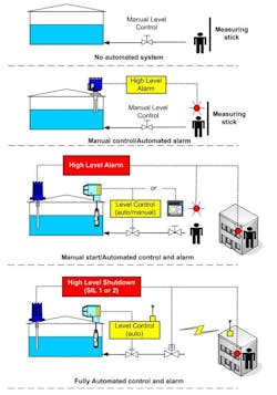

Figure 1. Automation found in tank farms and terminals can range from none whatsoever to full.

Estimating the likelihood of overfill is complicated by the combination of manual and automated control that's necessary as equipment is started up and operated. Figure 1 shows the range of automation commonly found in tank farms and terminals. The degree of automation generally relates to the expected rate of level rise and operator workload. Automated control and safety systems typically are added when control changes must be made too often to be continuously managed by the operator or when work complexity has increased to where the expected human error rate is no longer acceptable.
It's important to specify the safe fill limit and explain in operating procedures the consequence of exceeding it. Without clearly stated limits and consequences, the operator may not adequately monitor level, especially during intense work periods. Overfill is a credible event; it takes good operating procedures to reduce its likelihood.
