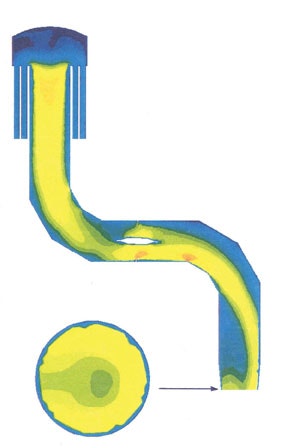

Figure 1. Pipe Flow Modeling Reveals Design Flaw
CFD analysis revealed that airflow was skewed by an unexpected interaction between two bends and the valve wafer in the normal open position. As a result, flow was concentrated on one side when it entered the blower, reducing efficiency.
FCC case cracked with CFD
As a case in point, Mobil Corp., during the past five years, has achieved tens of millions of dollars in capacity and product quality gains by using CFD to improve performance of refinery process units such as reactors, separators and extractors. In one case, Mobil engineers studied flow in the suction line of the main air blower that feeds the regenerator of a fluid catalytic cracking (FCC) unit. The FCC cracking reactions that produce gasoline and heavier liquid fuels also form coke on the fluidized catalyst, which is burned off in the regenerator using air.
The blower in question was designed to draw air at approximately 90 feet per second through a 6-foot (ft)-diameter line and supply it to the regenerator internal air manifold. The calculated blower efficiency was below 90 percent, significantly less than that of similar units and of critical concern because the FCC was blower-limited. Thinking that some nonideal flow feature might exist in the suction line, Mobil analysts used CFD to simulate the entire line, from the ambient air inlet to the blower intake port.
The 2.1 million-cell CFD model included all significant suction line details such as a chambered weather hood, several mitered bends and a butterfly valve with a tapered wafer. A high cell count was required because of the large line diameter and length, coupled with relatively small cells (between 1/4 and 1/2 inch [in.] on a side) needed near the walls to resolve sharp gradients in this area.
The analysis revealed that airflow through the line was strongly skewed by an unexpected interaction between two bends and the valve wafer in its normal open position. (See Fig. 1.) As a result, the flow was concentrated on one side of the line at the point at which it entered the blower ," a feature known to reduce machine efficiency. In effect, only half of the line cross-section and blower inlet was being used.
After gaining an understanding of the problem from the CFD results, Mobil analysts immediately thought of adjusting the equilibrium open position of the valve wafer. The clear advantage of this approach was that it sidestepped much more expensive modifications to the blower inlet and/or less-reliable tactics such as internal turning vanes.
After analyzing air flow through the suction line with the wafer in various positions, the analysts found a configuration that eliminated almost all of the nonideal flow pattern and allowed air flow rates several percentage points higher through the line at the same fixed pressure drop. As a bonus, plant personnel could implement the change simply by re-indexing the wafer relative to the positioning axle. On a blower-limited FCC, such a rate increase has the potential for capacity benefits exceeding $6 million per year.
