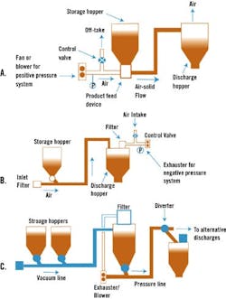

Positive pressure systems
Figure 1. Choose Wisely
The choice of a positive pressure (A), vacuum (B) or combined (C) system will be defined by product feeding and/or discharge requirements.
Multipoint feeding of a positive pressure conveying system generally is not recommended. The air loss from a single feeder subject to leakage can be a significant proportion of that required for conveying the product. The loss from a number of feeders, if they are not isolated by additional valves, could be very high.
The air loss from a number of feeding points could be difficult to estimate accurately. So, the air available for conveying, which is a crucial requirement, could not be guaranteed. Apart from problems associated with having too little or too much air for conveying the product, the loss of a large quantity of air from a number of feeding points also would represent a very significant energy loss for the system.
Negative pressure systems
A vacuum conveying system is not the answer if multipoint discharging of product is needed, since such a system requires complex arrangement of pipework and isolating valves. These valves are sometimes found in low-pressure systems where ductwork is used. Valves in the ductwork, however, have to seal effectively, otherwise the air leakage into the system will adversely affect conveying.
If air leaks into a negative pressure system, it will alter the balance of conveying air velocities along the length of the pipeline. If air ingress is not accounted for in the air mover spec, the line is likely to block. If the air mover is over-rated to allow for air leakage, product flow rate will be reduced. Air ingress is likely to occur along a pipeline at flexible sections such as those used in off-loading systems, particularly if the conveyed product is erosive and the joint is hard metal or ceramic material.
Combined systems
Operating pressures also will differ. With a Roots-type blower, for example, a pressure ratio of 2:1 is generally considered the upper operating limit. Thus for a positive pressure system the maximum delivery pressure is about 1 bar gauge. For a negative pressure system the maximum exhaust pressure is about -0.5 bar gauge. For a combined system, the limit on pressures is approximately 0.4 bar gauge on blowing and -0.3 bar gauge on vacuum.
Since the two parts of the combined system operate at different absolute pressures, the pipelines likely will be different diameters. Figure 2 illustrates this point.
Figure 2. Combined System Requires Two Pipe Sizes
Conveying air velocity as a function of air pressure, with lines of constant pipeline bore plotted, shows a typical negative-positive system superimposed for a free air flow rate of 0.3 m3/sec. Balance between the two parts of the system, in terms of conveying air velocities, is achieved with different pipeline bores.
Air also probably will leak across the feeding device on the positive pressure side, so the air flow rates will differ. An imbalance in product flow rates between the two halves of the system necessitates a full assessment of the operating pressures, pipeline bores and air flow rates.
