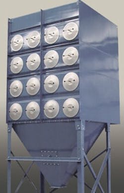

Horizontal Cartridge Dust Collector Provides Efficient Filtration in a Compact Size
The MikroFlo horizontal cartridge dust collector provides reliable, efficient filtration in a compact size.
Benefits
- Filter cartridges are quickly and conveniently serviced from outside the collector.
- The collerctor's modular, panelized design allows for easy capacity increases.
- Multiple units share common hoppers to minimize clean air ducting.
- The unit's compact design saves space and is suitable for spot filtration.
