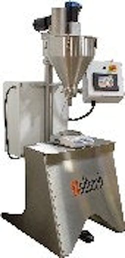

Nalbach Engineering Company has released its latest auger filling system.  The “S” series is specifically designed for manual, batch filling, applications.  This filling system can handle low volume, batch applications and applications in which the density of the product varies significantly.  It incorporates a scale to provide actual weight feedback to the filler and uses two fills per container.  The first fill dispenses 90 – 95% (user programmable) of the target weight and the second “top-off” fill is based on the actual calculated product density of the first fill.
Unlike “bulk and dribble” systems in which the first “bulk” fill is followed by slow series of “dribble” fills until the target weight is met, the Nalbach system's “top off” fill is a single fast fill.
The filler's control panel performs all set-up and operation of the entire system.  This “HMI” panel is an intuitive, icon-based, graphical user interface with touch screen and comes standard with all Nalbach Servo Driven Auger Fillers.  This controller provides a single point of user control for the entire system.
Nalbach's servo driven auger fillers incorporate PLC controlled brushless, direct drive, servo motor systems providing fill accuracy and reliability while reducing mechanical failures and downtime by eliminating most moving parts.
