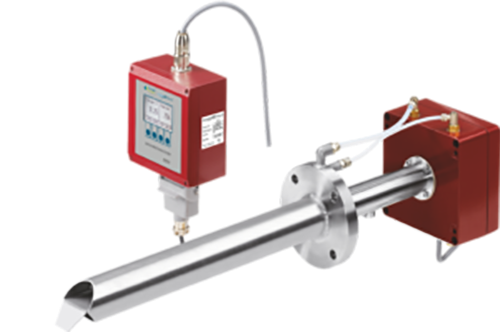

A new, compact process, in-situ gas analyzer from Process Insights, measuring combustibles (COe) and oxygen (O2), provides fast, optimal combustion control for applications like refining and petrochemical, power, steam generation and in furnace and kilns. The COSA Xentaur O2CX allows the process to operate safely with a lower excess air ratio, which reportedly translates into higher fuel efficiencies. With greater accuracy and sensitivity below 10% O2, the O2CX doesn’t require dilution air. Measuring combustible gas components, oxygen and COe reliably minimizes safety issues. Measuring in-situ directly has many advantages and is ideal for process heaters, steam boilers, thermal oxidizers and furnace optimization, according to the company.
Installation and service is easy as the flow guidance tube design allows the sensors to be located near the back of the transmitter, enabling service and maintenance without removing the entire assembly from the stack. The probe provides for both direct and continuous dual readings of oxygen and COe. The COSA Xentaur O2CX is also versatile for various mounting requirements or difficult applications, including high temperature, dust or hazardous installations.
