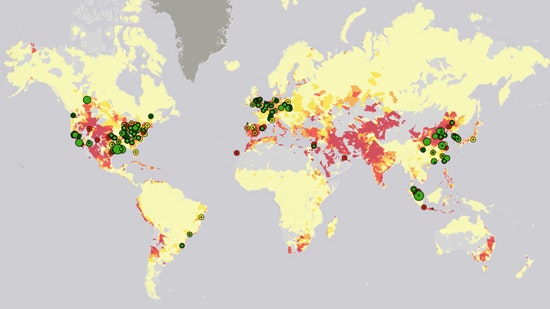

Members of Air Products’ water team spearhead the assessments and closely monitor water consumption. This team consists of representatives from our operations, environmental, procurement and sustainability groups and includes a GE Water representative. Most recently, the water team used geographical information system (GIS) mapping to evaluate our facilities based on the risk of water stress.
The team mapped water consumption for Air Products’ global production facilities against data from the Aqueduct database of the World Resource Institute (WRI). The visual tool, which took the form of a GIS map, integrated water consumption at our facilities with WRI data on drought severity, baseline water stress, groundwater stress and other water-related factors. Circles represent our facilities, with circle size indicating a plant’s absolute consumption of water (Figure 1). Color-coding shows the relative consumption on a unit-of-production basis as a percentage of water available. By looking at this map, the water team quickly could identify those facilities in water-stressed areas that were consuming a large or disproportionate amount of water. These sites were recommended for further evaluation and water assessments based on water stress and consumption.
Water Withdrawals
Figure 1. Map shows company’s plants in water-stressed areas, with size of circles representing amount of water taken and color indicating relative consumption on a unit-of-production basis as a percentage of water available.
Dark green = low (<10%); Green = low to medium (10–20%); Yellow = medium to high (20–40%); Orange = high (40–80%); and Red = extremely high (>80%)
