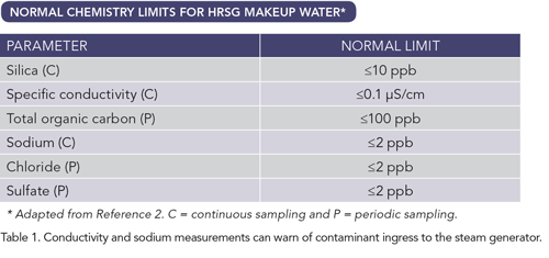

Impurities cause corrosion, scaling and other problems. These become more severe as boiler pressures and temperatures increase. Fortunately, the power industry has learned some lessons that directly apply to chemical plants, particularly ones that generate high-pressure steam for process needs or electrical generation. For example, Tables 1 and 2 summarize guidelines developed by the Electric Power Research Institute (EPRI) for makeup water effluent and condensate pump discharge (CPD) for heat recovery steam generators (HRSGs) [2].
Normal Chemistry Limits For HRSG Makeup Water
Table 1. Conductivity and sodium measurements can warn of contamination ingress to the steam generator.
