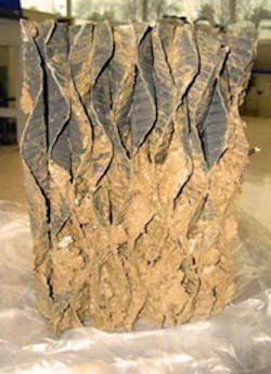

Cooling systems provide an ideal environment — warm and wet — for microbial colony formation. Bacteria will grow in condensers and on cooling tower fill (Figure 1), fungi on and in cooling tower wood, and algae on wetted cooling tower components exposed to sunlight. Biocide treatment is absolutely essential to maintain cooling system performance and integrity.
Fouled Film Fill
Figure 1. Fill, like other cooling tower elements, offers an attractive surface for microbial growth. Source: Ref. 1.
