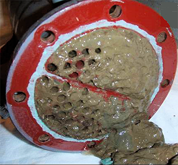

This often is the most problematic and severe issue in cooling water systems (Figure 1). Even with fresh water as the makeup source, such fouling can occur rapidly. The risk has gotten even worse at many plants that now have switched to alternative, lower quality water, e.g., secondary wastewater plant effluent, for plant makeup. Such supplies potentially can introduce large quantities both of nutrients (nitrogen species and phosphorus) and food (organic compounds) to cooling water, thereby increasing the potential for fouling.

Figure 1. Severe fouling can afflict a heat exchanger (left) and tower fill (right) in a cooling water system.
