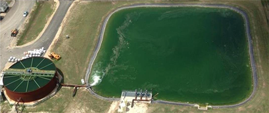

A large Southeastern industrial complex was using a polyphosphate corrosion inhibitor program. Influent water to the plant enters a large open pond and then goes to a settling clarifier. Chlorination takes place in the clarifier, with its discharge, approximately 4,000 gal/min, dosed with the corrosion inhibitor. After servicing a number of once-through cooling heat exchangers, a recirculating cooling tower and other process cooling needs, a portion of the water recycles back to the pond.
The phosphorus in the return water provided ample nutrients to support robust algae and microbiological growth, which in turn increased the biocide chemical treatment costs and fouled intake screens. Figure 1 shows the condition of the pond during the summer of 2014 when the phosphorus-based corrosion inhibitor program was in use. Similar to natural water systems with phosphate loading, the water has a deep, opaque green color.
Fouled Pond
Figure 1. Phosphorus in return water fostered substantial algae and microbial growth.
The total phosphate concentration in the pond was 3–4 mg/L. Despite the presence of the polyphosphate corrosion inhibitor, mild steel corrosion rates in the hot return of the once-through cooling water averaged a barely acceptable 8–10 mils/yr (mpy).
To reduce biological growth, the facility converted the corrosion inhibitor program to 0.5–1.0 mg/L zinc in mid-September 2014. Corrosion rates on the zinc program dropped to an average of 2–4 mpy and the condition of the pond water improved considerably. Efforts to further reduce corrosion using higher levels of zinc alone led to some fouling of high temperature heat exchange surfaces.
At the end of May 2017, the site switched to a ChemTreat FlexPro non-phosphorus and non-zinc corrosion inhibitor program, which has the further advantage of being non-fouling. The inhibitor was applied at a concentration of 5 mg/L as formulated product. The initial corrosion coupon result was 3.4 mpy, comparable to that of the zinc corrosion inhibitor. Corrosion rate meter results in the clearwell supply water are in the 0.1–0.3 mpy range, the best ever achieved on any program in this application.
The appearance of the pond greatly improved after the conversion to non-phosphorus programs, as expected based on experience with phosphorus reduction in natural water bodies. Figure 2 shows the pond in the summer of 2017 after the switch. The total phosphate concentration is approximately 0.1 mg/L as PO4. With only the minimal natural phosphate loading in the source water, the pond water is crystal clear.
