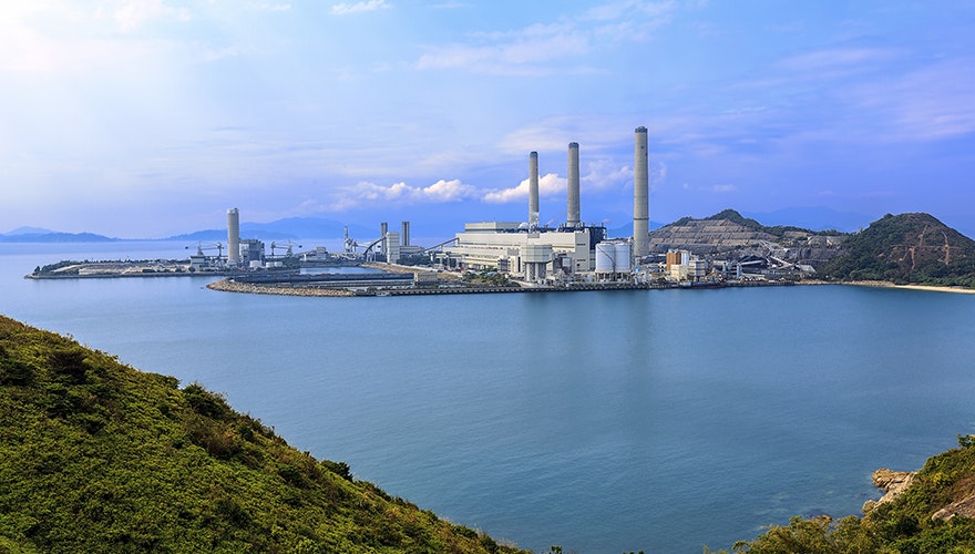

Many chemical plants across the globe use seawater as a cooling medium. Depending on specific plant cooling requirements, these systems can demand several thousand gallons of fresh seawater makeup per minute. The high volumes of makeup water used represent a significant expense on two fronts: the energy to pump the water and the chemicals to treat it. So, optimizing both seawater demand and chemical treatment strategy is critical.
However, plants that rely on seawater for cooling have struggled to do this. For years, conventional seawater cooling programs have used outdated chemistry guidelines that were adapted from freshwater cooling systems or oilfield brines. These adaptations can be imprecise and have led to an unending battle against a range of negative outcomes: high chemical costs, reduced heat transfer efficiency, unscheduled plant shutdowns, lost production, steep maintenance expenses for electrochlorinator units, and excessive water pumping.
Fortunately, new approaches that use digital monitoring and computerized saturation models to optimize cooling programs have emerged. For instance, SUEZ Water Technologies & Solutions’ new OptiSea chemical treatment program combined with its proprietary MonitAll digital monitoring device have enabled several advances on this front.
Here, we’ll look at common problems that arise from the use of faulty models in plants relying on seawater for cooling, and how new digital strategies are overcoming these difficulties.
