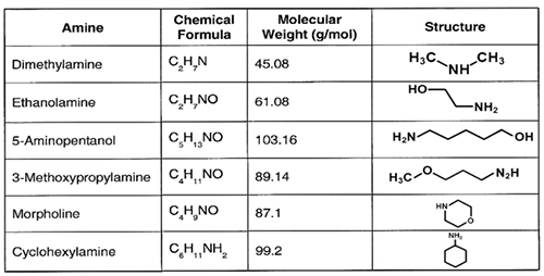

Common Neutralizing Amines
Figure 2. Boasting higher molecular weights than ammonia, these compounds won’t flash off as much.

Because this is a reversible reaction, the alkalinity increase is limited, which usually minimizes excessive corrosion to steel in the event of a chemical feed upset. (Copper alloy corrosion is a completely different story.) For industrial boilers, neutralizing amines (Figure 2) are a common choice for condensate/feedwater pH conditioning. These are small-chain organic molecules with an ammonia group attached to or embedded within the compound.
The amines all have a higher molecular weight than ammonia and, thus, won’t flash off nearly as extensively as ammonia does to steam — although each has its own distribution ratio, i.e., the amount that remains in the water versus that which departs with steam, whose properties are a function of temperature and pressure. The products also have different basicities, which provides flexibility in selecting a treatment program. Careful evaluation of boiler operating and design conditions is necessary to select the most appropriate amine or amine blend. Some compounds aren’t allowed if the steam can directly contact food and other consumable products.
Neutralizing amines often are very important for minimizing corrosion in condensate return systems, particularly if the boiler water contains significant alkalinity. Carryover of CO2 to steam can depress the pH in the recovered condensate; substantial iron corrosion may result unless the pH is adjusted with a neutralizing chemical.
